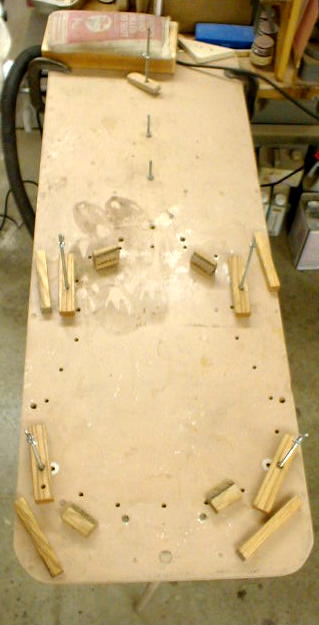

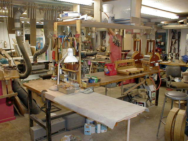

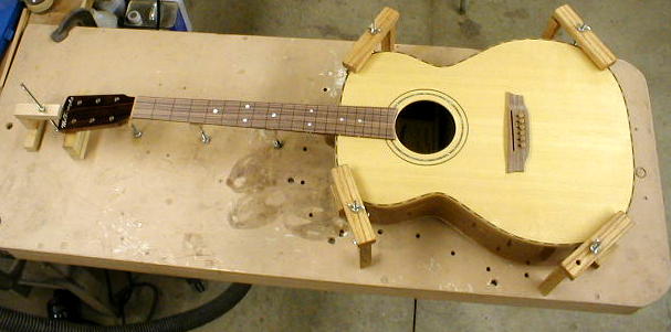

Here are some rather cluttered pictures of my main work bench. The main bench is 30" wide x 10 feet long. The "L" shaped extension is 4 feet long and is where I do 75% of my work. Both benches are accessable from both sides.

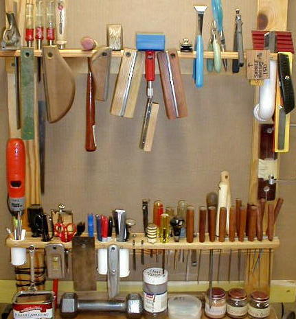

The above tool rack is an arms reach from by "L" bench extension. It also has several T nuts inserted in it so I can jig up a guitar and neck while setting up the neck. See below.

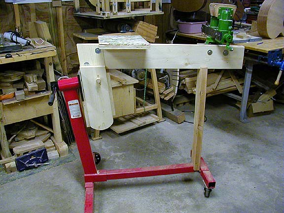

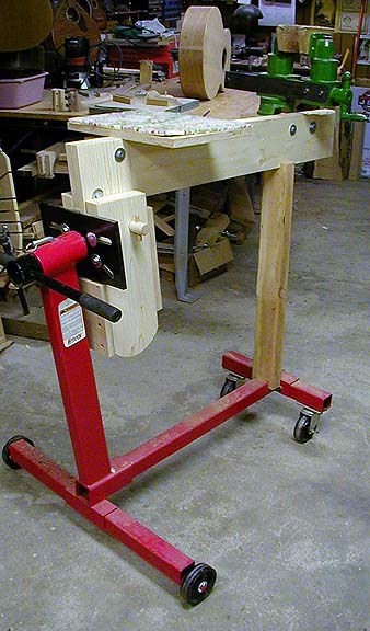

I just built myself a mobile workbench, after I saw the nice Stew-Mac Shopstands in use at the ASIA meeting. Their stand was sitting on a concrete slab, but I wanted to roll mine around the shop to get it out of the way when I wasn't using it, or put it where I wanted when I was trying to do something. I was thinking about what I would use as a starting point...then, on the Grizzly website I saw their Engine stand and I had my answer. I just made the wood parts for it, and had my shop stand- it can move all around the place and with my vice bolted on the end it works great! Plus, it's rated at 1000 pounds for those heavy guitars. <G> This stand from Grizzly cost a whole 37 bucks. Sorry, but my shop is cluttered too!

My 10' bench [with a 2" laminated maple top] is so heavy it takes "two men and a boy" to move it. No anchoring is necessary. The small "L" extension is just C clamped to the main bench and it has a 1" dowell supporting leg at the other end.
